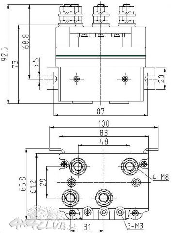

prikladam link na selenoid bezne dostupny na nasom trhu :
ZJSF-41 12/24V
http://www.ruidianchina.com/en/display.asp?id=54

Shape installation Banner:

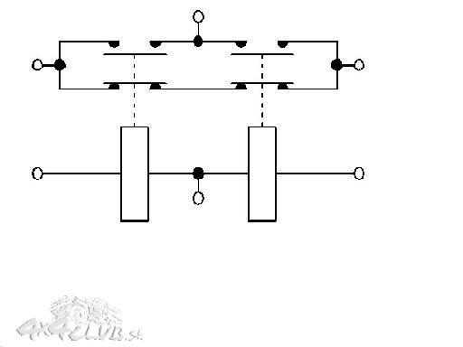

Line schematic:
