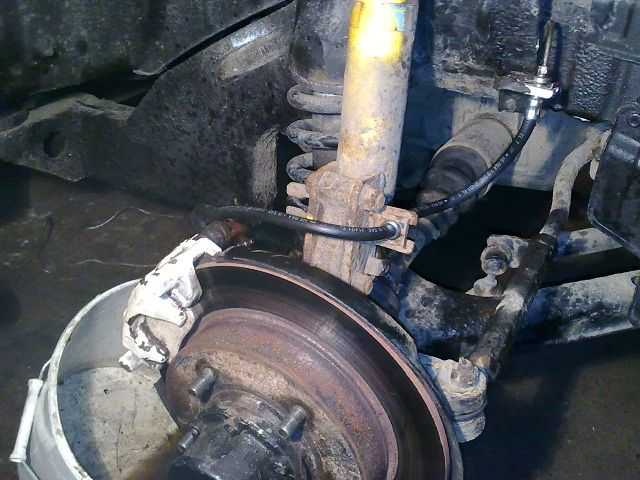

Zopar fotiek:
Stara hadička:
http://www.4x4club.sk/pictures/viewer ... 6zkzfv.jpg
Nová hadička-prava strana
http://www.4x4club.sk/pictures/files/ ... c3sls9.jpg
Nová hadička-ľavá strana
http://www.4x4club.sk/pictures/viewer ... i1g1w3.jpg
Blicky
http://www.4x4club.sk/pictures/files/ ... 3byx4a.jpg
