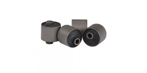

Netreba, ale ked to chces mat 100%tne tak by si mal dat este caster kit:
http://www.offroad24.sk/kategoria/podvozky/ironman-4x4/casti-podvozkov/ironman-4x4-suzuki-jimny-1998-sada-prednych-excentrickych-puzdier-na-zmenu-zaklonu-1146rk/
